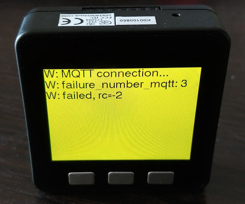

Log display in case of warning
If the gateway detects a warning or an error the sleep go out the sleep screen and show the message with a red (error) or orange (warning) background. M5 Stack core warning
