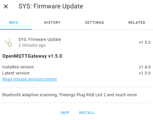

Firmware update from MQTT (ESP only) ​
When the gateway used is from a standard ESP32 environment listed and defined here, it can be updated through a simple MQTT command:
mosquitto_pub -t "home/OpenMQTTGateway_ESP32_BLE/commands/MQTTtoSYS/firmware_update" -m '{
  "version": "latest"
This would download the latest version firmware binary from Github and install it. It can be used with version 1.5.0 and above.
Note that this update option is also autodiscovered through Home Assistant convention, you can update directly from the device page with 2 clicks.
Home Assistant OTA Update
You can also indicate the target version to update:
  "version": "v1.2.0"
OpenMQTTGateway checks at start and every hour if an update is available.
