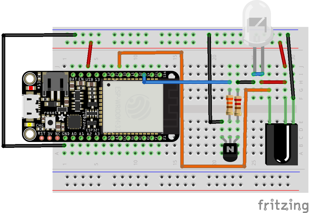

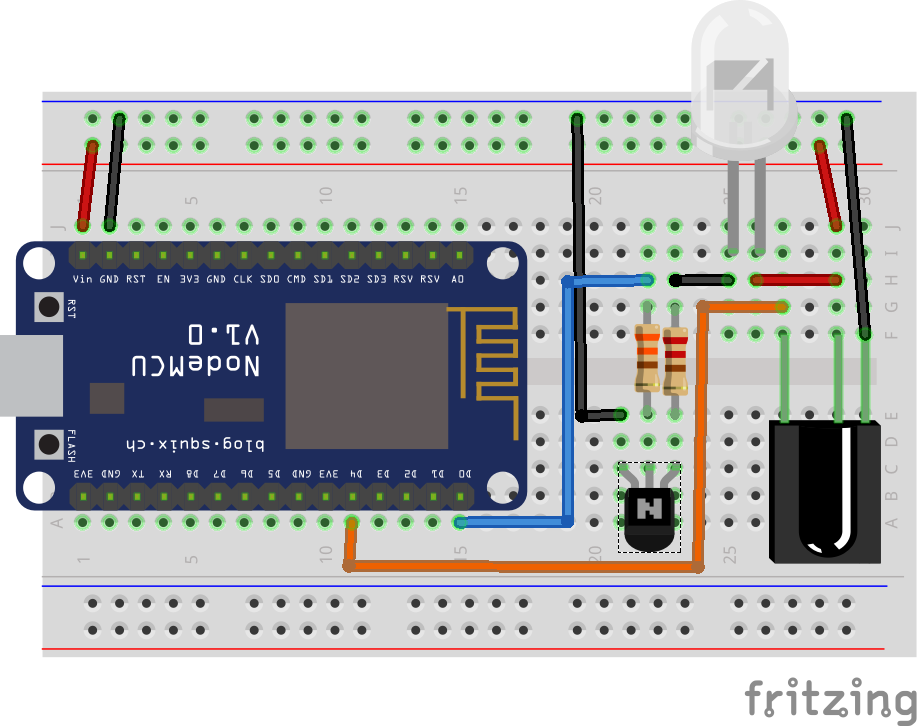

ESP8266D4D0
ESP3227/2614
Connect the Emitter and Receiver to a 5V supply source, and the ground of your supply source to the ground of your board.
ESP8266 Hardware setup ​
IR
ESP32 Hardware setup ​
IR
