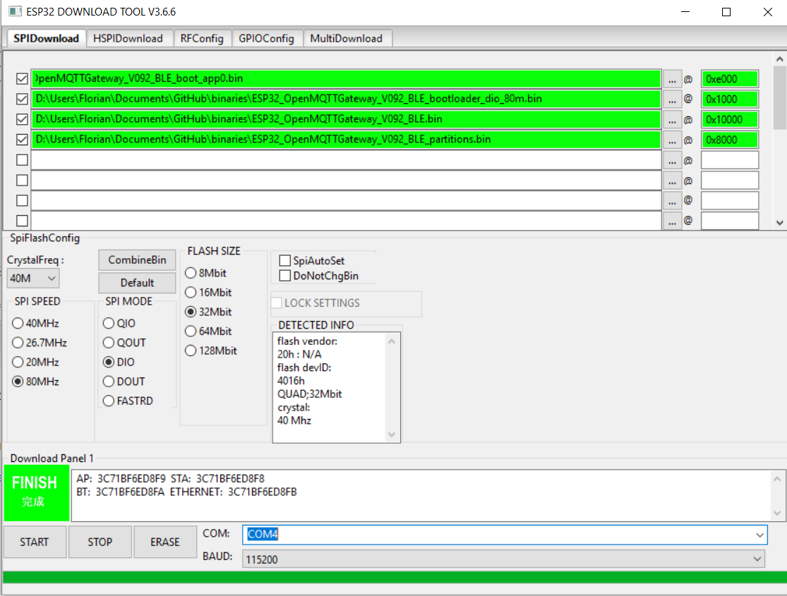

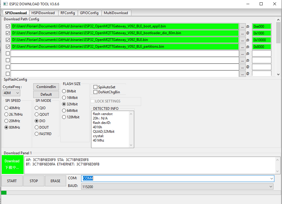

  • Set the files and the address as below: Flash download tool
  • Set the config as above
  • Connect your ESP32 board and select the COM port
  • Click on erase if it is your first upload
  • If you see SYNC (above the START button) for more than 5 seconds, press the boot button of your ESP32
  • Once done you can click on START button
  • If you see SYNC (above the START button) for more than 5 seconds, press the boot button of your ESP32 The upload details appears in the rear shell windows, you can see also the progress bar changing.
  • Once done the flash tool display "FINISH" like below Flash download tool 2

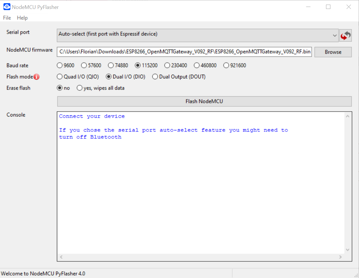

ESP8266 ​
With an ESP if you did not set your network and MQTT parameters manually you can now open the web portal configuration.
Note that to reset the wifi and MQTT settings you can check yes, wipes all data
