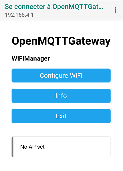

WiFi manager menu
  • Click on Configure WiFi

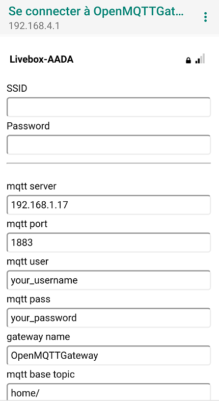

WiFi manager parameters
  • Select your WiFi
  • Set your WiFi password
::: note If the board is connected by ethernet, the Wifi and password can be empty. If you fill them the board will use this wifi as a fallback connectivity method. :::

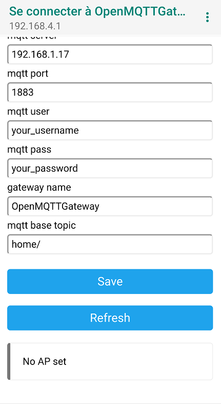

  • Set your MQTT Server IP or domain name (for Home Assistant you can enter homeassistant.local if your server is configured with mDNS)
  • Set your MQTT Server Port (default: 1883)
  • Set your MQTT Server username (optional, 64 characters maximum)
  • Set your MQTT Server password (optional, 64 characters maximum)
  • Set your MQTT base topic if you need to change it (you must keep the / at the end) (default: home/, 64 characters maximum)
  • Set your gateway name if you need to change it

  • Click on save
WiFi manager save
